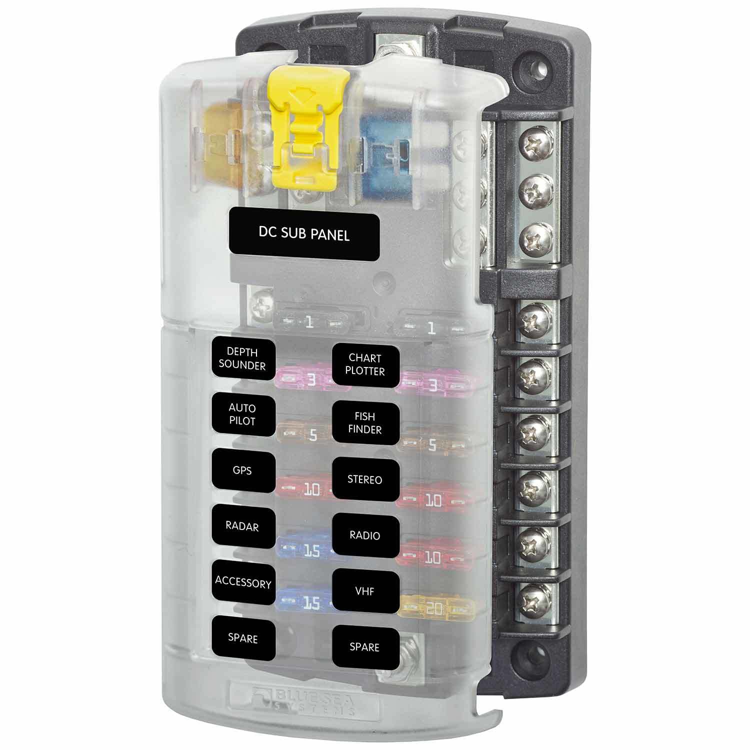

In my 99 Sailfish (dont own it anymore) there was a fuse panel up top in the electronics box and a second under the steering wheel. I needed to replace the one under the steering wheel which got corroded over time. I'd check the condition and connections on of both of those to see if there are any issues. Below is what I replaced it with.

I'm in the middle of this on my recently purchased 03 Sailfish. I have replaced the fuse panel with one like suggested above, I replaced all the wire ends going to it with heat shrink ends. Then there is also a neg and pos bus bars at the helm too, I replaced both of those as well along with all the wire ends.
