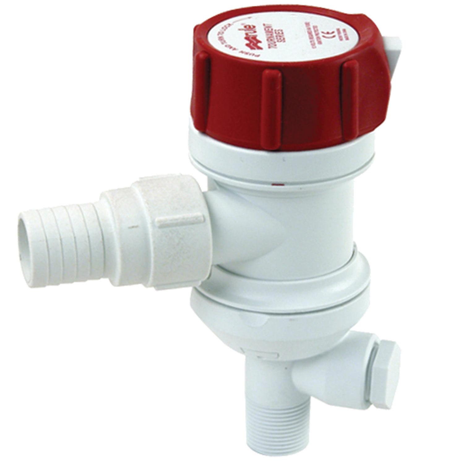

Some folks do use a livewell pump output through a selector valve to create a raw water washdown source. It will work but as you suggested, it make provide a weak flow.
Better approach is to get a dual port livewell pump ( you may already have one), connect the secondary output to a new washdown pump and all the previously mentioned parts.
