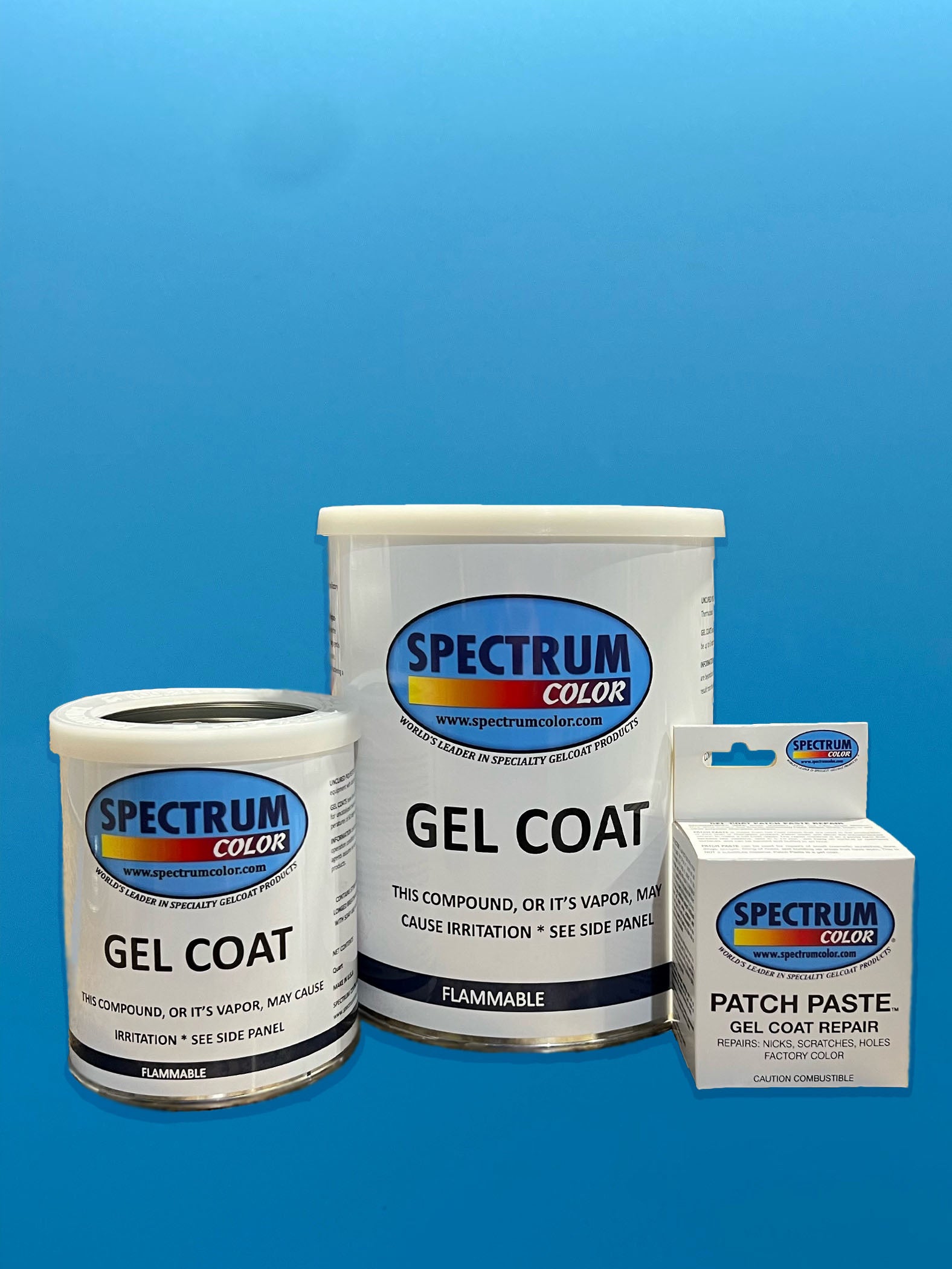

Spectrum sells color matched GW repair kits base on your model year. Process is easy but your gelcoat has sunbleached and is very white compared to the original. You can go with white and get a brown tint and try to match yourself.

i bought 2oz past from spectrum , and i will make a try.

I have some small nicks as well in my gel coat but I didn’t see where you can purchase just the 2oz paste, I could only see the quart size for $375 that looks like it comes with the 2oz paste. I’m up in Canada so I wonder if it’s a different website with different options.
