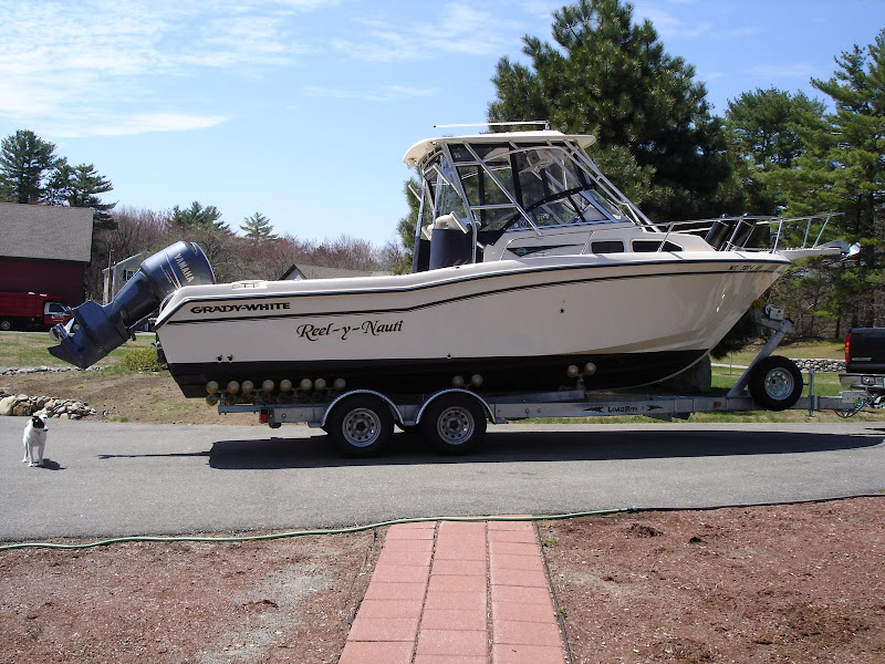

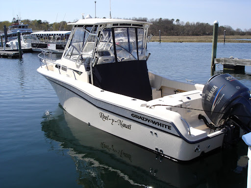

I'll attempt some pics here. Hope it works.
