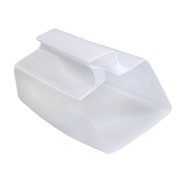

I can't tell hold finds ow deep the water is but I would find a flat bottom scoop, collect some water in a jar and see what you get. Fuel will float.

They are two strokes, and where you’re looking in the bilge is just forward of the transom, and just aft of the fuel tanks. I’ll try the jar/scoop trick shortly.
