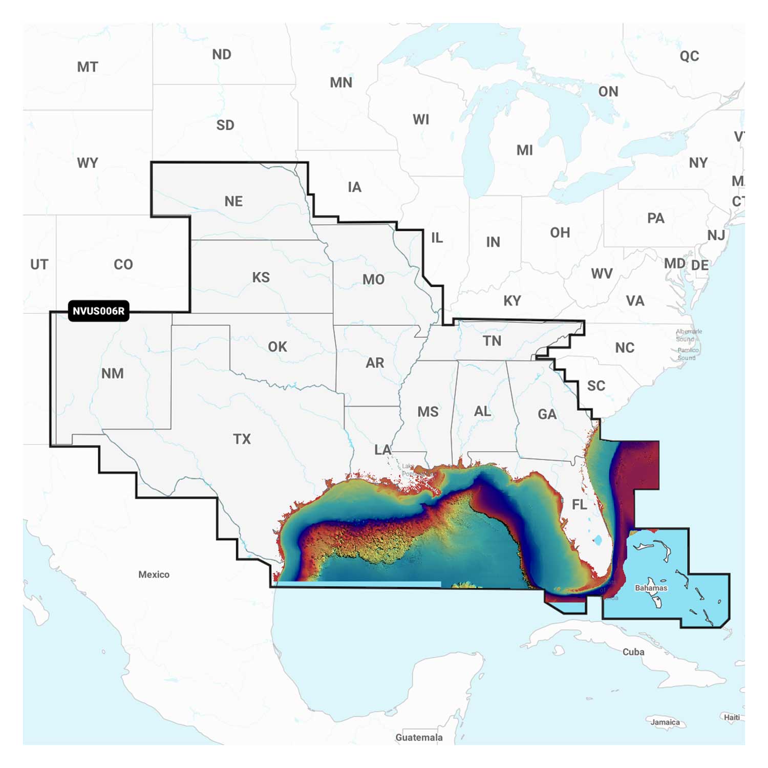

West sells four versions of US006R SD card but only one of them will work. Make sure they sold you the correct one. Should have been $249.99. Amazon has the SD card for $133.13. My West Marine will price match Amazon.
Let's be exact. You bought a Garmin Navionics Vision+ NVUS006R SD card version a few weeks ago - correct?
Go to Garmin.com and login. User>Account>Manage Your Data>View your data>View your subscriptions. You should see your subscriptions. Tell me what the chart codes are. Does your new NVUS006R subscription show up?
This is how you register the new NVUS006R SD card with Garmin...
Once registered the VUS006R subscription will show up in your Garmin.com account and in Active Captain>Charts>My Charts.

I'm convinced you got the wrong card. You should have purchased the NVUS006R not a vus006r. The price you paid West Marine isn't for the NVUS006R - should have been $249.99. If you could put a photo up of the codes on the box and maybe the SD card. This is the card you should have bought at West Marine. West doesn't have it labeled correctly but Hodges and West have the same product code 010-C1290-00 in the listing.
