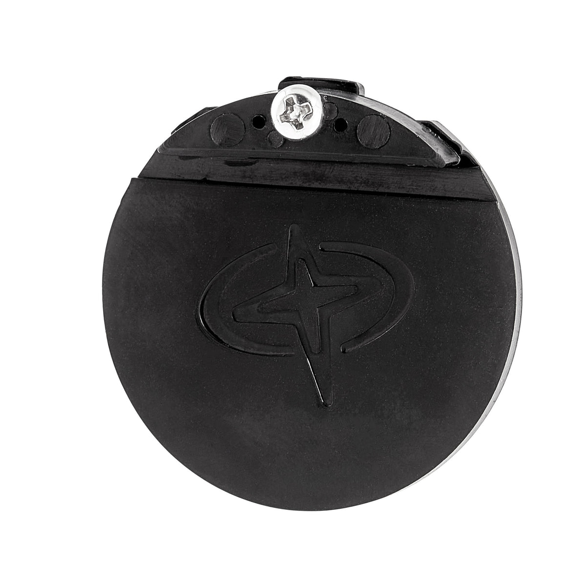

  • I notice when I am in the rear of the boat, the scupper on the side I am standing seems to go a little below the water line and let some sea water in. I also noticed the automatic bilge pump go off at least 3 times in the 2 hours I was puttering around. Is that normal for this model?

Welcome aboard. In regards to the scuppers letting in water as well as the bilge pump going off... when I first bought my boat, a 2004 Grady White 228 Seafarer back in October of 2021, it would let water in as well when standing back there. Up on a plane it was no issue, but myself or my uncle standing back there and you'd get a small pool of water as we're both around 275 lbs or so. Simply replacing the rubber scupper flappers was all that I needed to do to remedy that situation as the rubber can get brittle, twisted or not seal completely, which allows the water to come in when extra weight is back there. You can get them locally from your local GW dealer, or there are a multitude of locations online you can get them. These are the ones from the local GW dealership at almost $10 a piece, which is quite a joke. You can get them for less online, or different brands like Gemlux or others sell them for a fraction of the price. I'm wondering if the bilge pump going off was because there was some water still in the boat that wasn't completely drained out all the way? Lots of boats have small nooks or crannies to where they won't drain 100% completely when on the trailer unless the boat is completely vertical. I'm betting that when you accelerated or got up on a plane, and then conversely slowed down or came to a stop, it likely freed up some of the water or it hit high enough on the bilge to pump it out. In regards to your second question... I'm not positive but my guess would be that the valve is what actually switches the tanks from the primary to the auxiliary tank, and then the switch at the dash switches the gauge or sending unit/sensor to show the correct level of fuel for each tank? I admittedly don't know very much about it as my boat just has the standard 92 gallon main fuel tank without having an auxiliary tank. But that would be my guess, and I'm sure someone will come along to confirm or deny that.

Old scupper valves cat let in water when they either stick open a bit of fail to close The scupper flapper valves however will not completely seal and you may always get a bit of water with the lower scuppers. That said, in reverse, you may get a lot of water if the flaps don't seal. When you look for replacements be aware that some Grady scuppers use a not so easy to find size and you may be forced to buy the expensive OEM parts.
1/16 of an inch difference in diameter can have a big effect on how they work.
You can but a multi size kit form manufacturers like TH Marine. I think there are three sizes and if you get lucky, one or even 2 may be good replacements.

I imagine, though I'm not 100% positive, that the scupper flappers on your boat are likely the same as on mine. I just got some the other day and confirmed with the local GW dealer before doing so, that the proper size for my boat is a 1.5" scupper flapper. A quick call to your local GW dealership would solve that issue rather quickly, and with you having a dock on both sides of the boat... you might even be able to replace the scupper flappers like there.
On my 208 hull, there are two scuppers for the deck and two for the motor well. The flappers for the 4 are not the same diameter. I don't remember which is what but one set is 1/16 inch different. I think the deck scuppers are the smaller size and if you use the same size as the motor well, the flapper looks fine but wont open'.
That's why you should take the old one to the store for comparison
