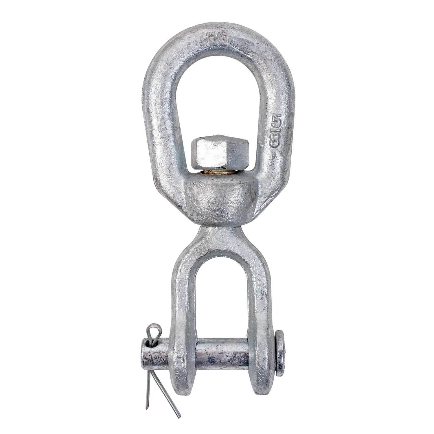

This is the swivel in question. The thick side connects to the chain and the narrow end connects to the anchor. The slotted screw in the front came out. I just ordered a whole new swivel for $25 on Amazon instead of trying to find the right bolt.

Personally I would try to find a different swivel to limit the chances. Then use a shackle with monel seizing wire like family affairs picture
there is this one from WM.. i think on my rig is a swivel with no bolt… will check if i can find… tbh i think most anchor setups I’ve used didn’t bother with a swivel shackle and never really had an issue with twist

Oh, OK. I thought (I think we all were) that you were referring to a standard shackle.
In this case, yes, the only thing that you can use is loctite. Which, "should have" been on there from the manufacturer.
Be careful with those cheap/inexpensive "over-seas" swivels - they may not have the proper rating for poundage... or a cheap connecting pin (the swivel part being of inferior metallurgy). Meaning, they may "look" good... but could break and fail. It's not a huge deal when you're just sitting there at lunch - but if you NEED it to work, it's best to get a quality piece.

I'm just going to take the pin out and use it on the old swivel, then keep the rest of the new swivel in my boat tool box just in case I have another issue.
