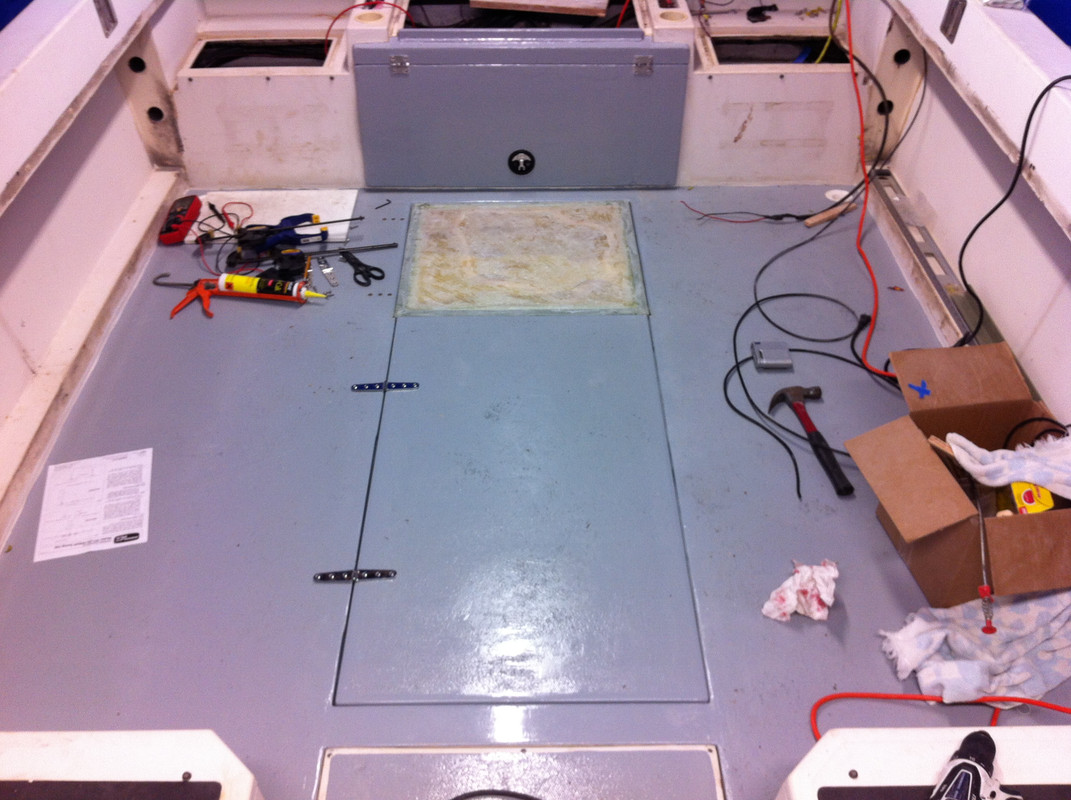

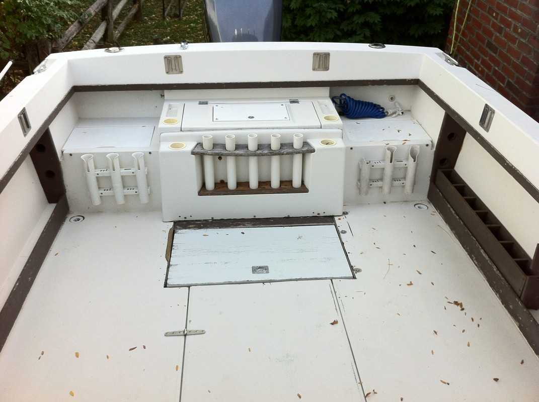

Just a quick heads up... my boat was swapped to an outboard, but the original cutout where the engine would be was never sealed and it led to two, small areas that were soft (similar to what you are talking about). The wood/area that is soft WILL be much larger than you think it is. The "messy" (second) picture is one I took part way through my rebuild. Just throwing these in there "for fun" and what you "might" be getting yourself into. Hopefully not, though!
