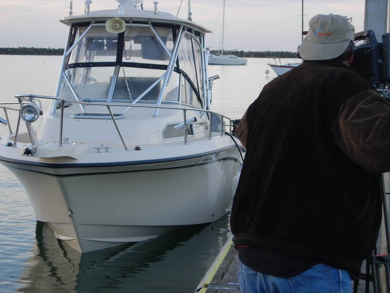

i took the stainless steel fittings from an old rod holder, bolted the light to the rail over the bow pulpit, ran the wire back to the aux switch it works great! i also switched out the 400,000 candle beam for a 1 million candle beam for a little more light. it is obviously not ajustable from the helm so i just leave it with about a 20 degree down angle. that's fine for running and light's up about 25 yards ahead of me in the harbor. it was supposed to be a temporary "fix" on my old boat but worked so well that i installed one on the new boat as well. it's nice not to light up the forward deck. alan
I installed one under my hardtop on my 33 express. Reflected so bad I couldn't use it without a relector pan under it. I ended up putting this unit in..(see below) Mounted in pulpit. It has perko socket with remote.. Only has to be out in the elements when you need it.. Slick..... tied it into my power for the windlass.
