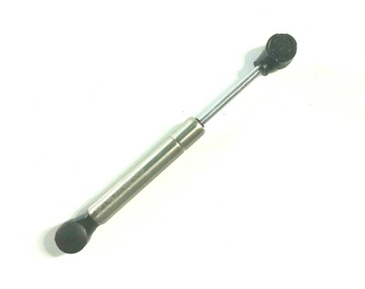

This is a new one I bought for my baitwell lid. These were the numbers I had when I purchased the new ones, matched what was there.

Thanks for all the help with the gas struts...I ended up buying one with slightly less strength due to shipping costs, plus was about 10-15 less than the 55lb
I just installed today and it worked...$28 for shipping and all

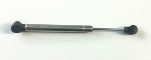

amamola is correct. 625-3 is for the boxes behind the helm seats, the 625-2 are for baitwell.
Here's a pic for comparison. The longer ones are the 625-3's. Both sets of mine are the 55# ones.

9,179
1,320
The strut in the photo says it is 55 pounds, an odd number and I suppose a 50# as would be fine. I do not know what the difference between the middle digit '3' and a '2' The manufacturers phone number is printed on the strut and maybe that can advise.
