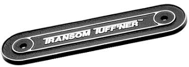

Is the inboard side of the transom braced in any way or are there just large washers where the OB bolts through?
My boat had some flex from a larger OB and a transom Tuffner plate was installed. It stiffens up the connection considerably.

That's a nice bracket brace. I caulked the aluminum trim cap with Boat Life polysulfite. The silicone stuff just peeled off. Should hold until I haul out next year, I hope.

I don't think the brand matters but I will have one on whatever boat OB powered boat I own from now on. I see it as a way to stiffen up a transom that might flex better yet as a preventative measure before flexing or stress cracks appear.They are cheap so there is no reason not to automatically mount one with a new motor.
7,736
1,203
^^^ Agree with Mike on this one. That should be a standard item from the factory.

All that thing does is distribute the load from the engine mounting bolts. It's not wide enough to be considered any sort of a transom brace.
