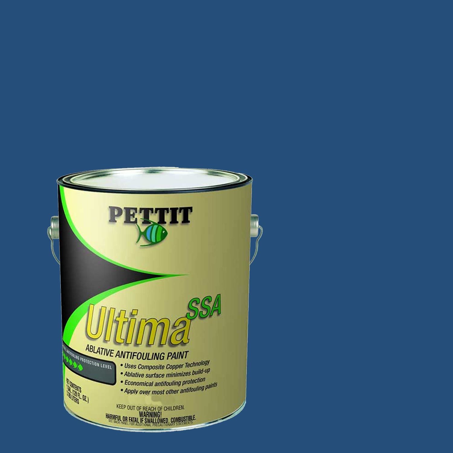

I'm not sure what the process is. I just ordered a gallon of paint, because West had it on clearance for $33. That's my starting point, never had a painted bottom, but hope to be in the slip more this year.

It is very important to follow the instructions not just for the painting but for the prep work. If you do not follow the steps for prep, you probably will have failures with the bottom paint.
Take a look at the Pettit site
and then at the How To tab. Lots of good info and how-tos on the site

It's also very important to see what bottom paint works for your area. Not all bottom paint works in all waters. You should check with others in your marina to see what everyone is using. I use Micron CSC. I used Micron CF once, and had horrible results. Saving a few dollars can add up to $$$$$ to correct in the future. Also, I would recommend applying a barrier coat to the bottom. The Bottom prep is critical to the application and final outcome.

Like I said, it's a starting point, and I will have the work done by an experienced shop. I may end up with a different paint, but I figured $33 was low risk, and I can re-sell if it's not what I need. The status is now back-ordered at West, so I may never see it anyway.

Read up on it. It would be a mistake to just use anti-fouling paint.
https://www.westmarine.com/west-advisor/Epoxy-Barrier-Coats.html
If you have bare gelcoat now and you are going to put the boat in the water for weeks or months at a time, you should FIRST use an epoxy barrier (usually 3 coats) and then 2 (or 3) coats of ablative anti-fouling. After that, typically you can recoat ech season with one coat.
Epoxy barrier is a 2 part paint. timing and weather dependant. The hull needs to be DRY. The weather needs to be warm & DRY.
It not cheap.
Interlux or Pettit or TotalBoat

Many shops won't use customer supplied paint. If they do, keep in mind that if the paint fails, in any way, you can't go back to them to remedy it. If you let them use what they know will work and the paint fails/chips off/etc, they "should" take care of it.

Gallon will do it. Get a good multi season ablative paint as you will have enough to touch up next year. Best to talk with folks in your area on which to use. Some formulations are better than others in areas.
