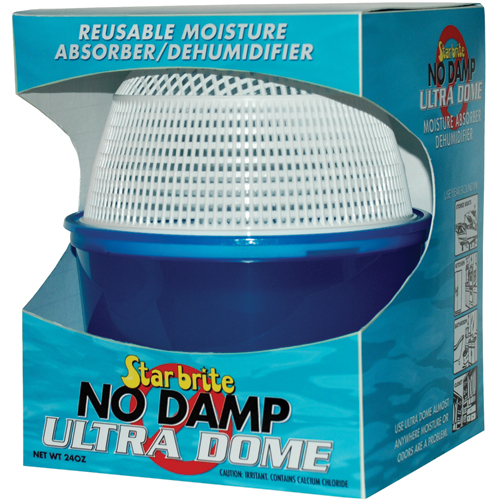

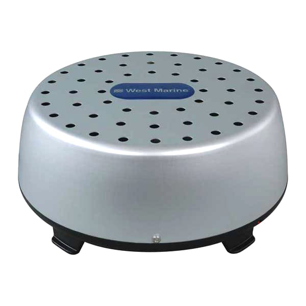

Unfortunately where there is no sun there is the opportunity for mold. You have to stay on top of areas like this. Best product to clean mold I've found is Nautical One Extreme Mold Remover.]
There are a lot of products out there that will work from bleach and water to commercial mold cleaners sold at HD and Lowes.
To prevent mold you can use an electric dryer, a light fixture with and incandescent bulb if you have electricity or damp rid or the strips.
I like strips and Nautical One if you have no shore power. I use the drier, Nauti One when at the dock and the strips for layup.

Under the right conditions, sure, mold is "normal". The trick is preventing the "right conditions" :) And this is not always easy on a thing that spends it's life near the variables that lead to mold. As others said, clean it really well (even just plain bleach and water can work) - try to keep it dry - and ventilate the area (can you leave a door/hatch open when you're away?). Some of the products noted above might be a good idea, as well, like a damp-rid bucket.
