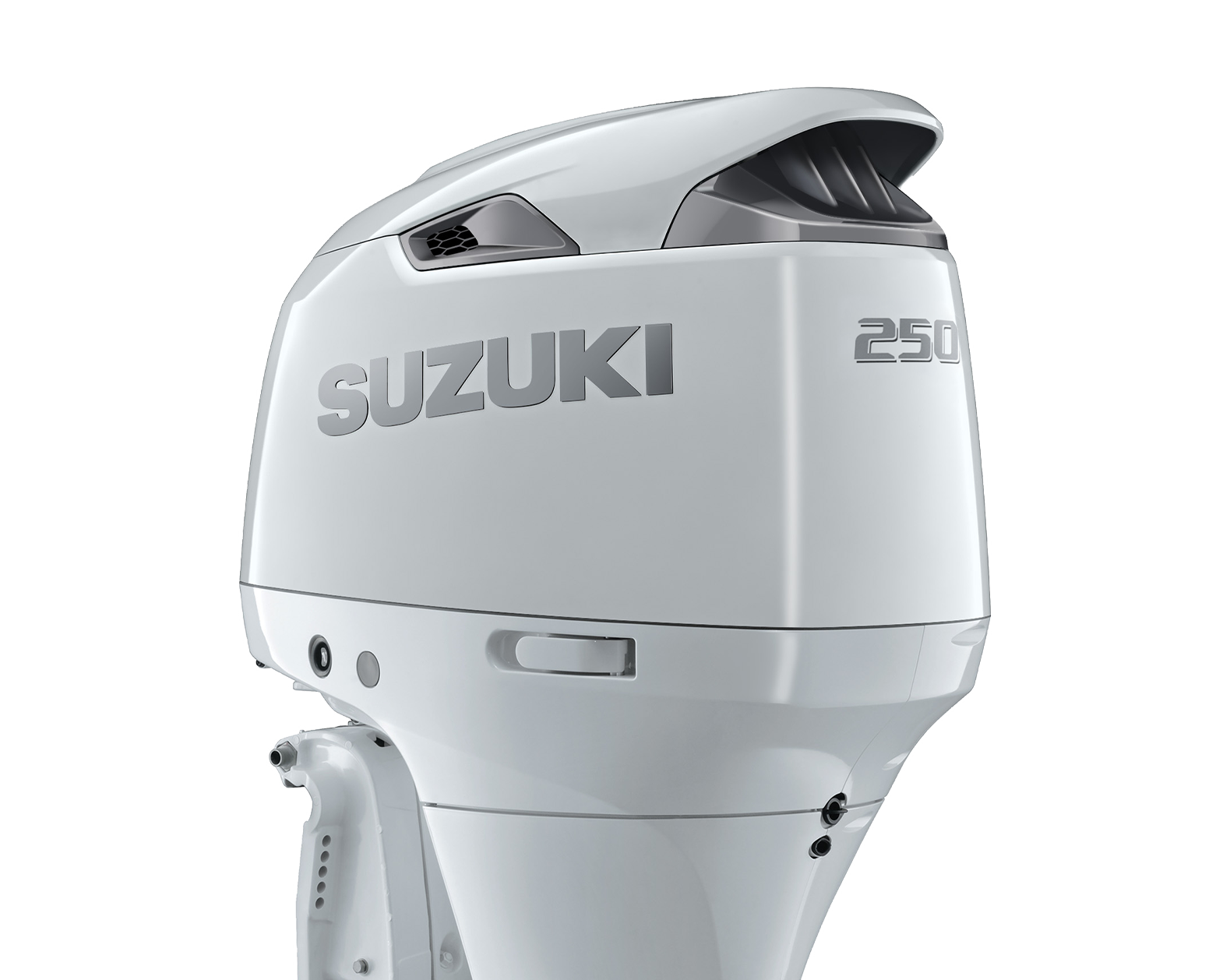

For digital steering, there is the DF250AP, the depotentioned DF300AP what is a awesome engine too, but price would be considerable higher and honestly the AP (selective rotation) system is not really useful. There are two points what makes the selective rotation of use:
1) you can easily invert rotation to check if inward or outward rotatin gives better performance
2) you could carry only one spare propeller and after telling the engine what rotation the prop is you could return with both engines.
However, swapping a propeller in the open sea is much more complicated (and can be dangerous) as people think and i would not recommend that eccept it's a matter of life and death. Did that in the Marina and it was complicated and i would not do that offshore with some waves.

The DF200APs are plenty enough for the boat. You get digital controls for the price of mechanical Yammie i4 F200s.
DF225s are only mechanical and weigh the same as a DF250AP. The hull is rated at 450hp...maybe the 2003-5 bumped up to500? idk
