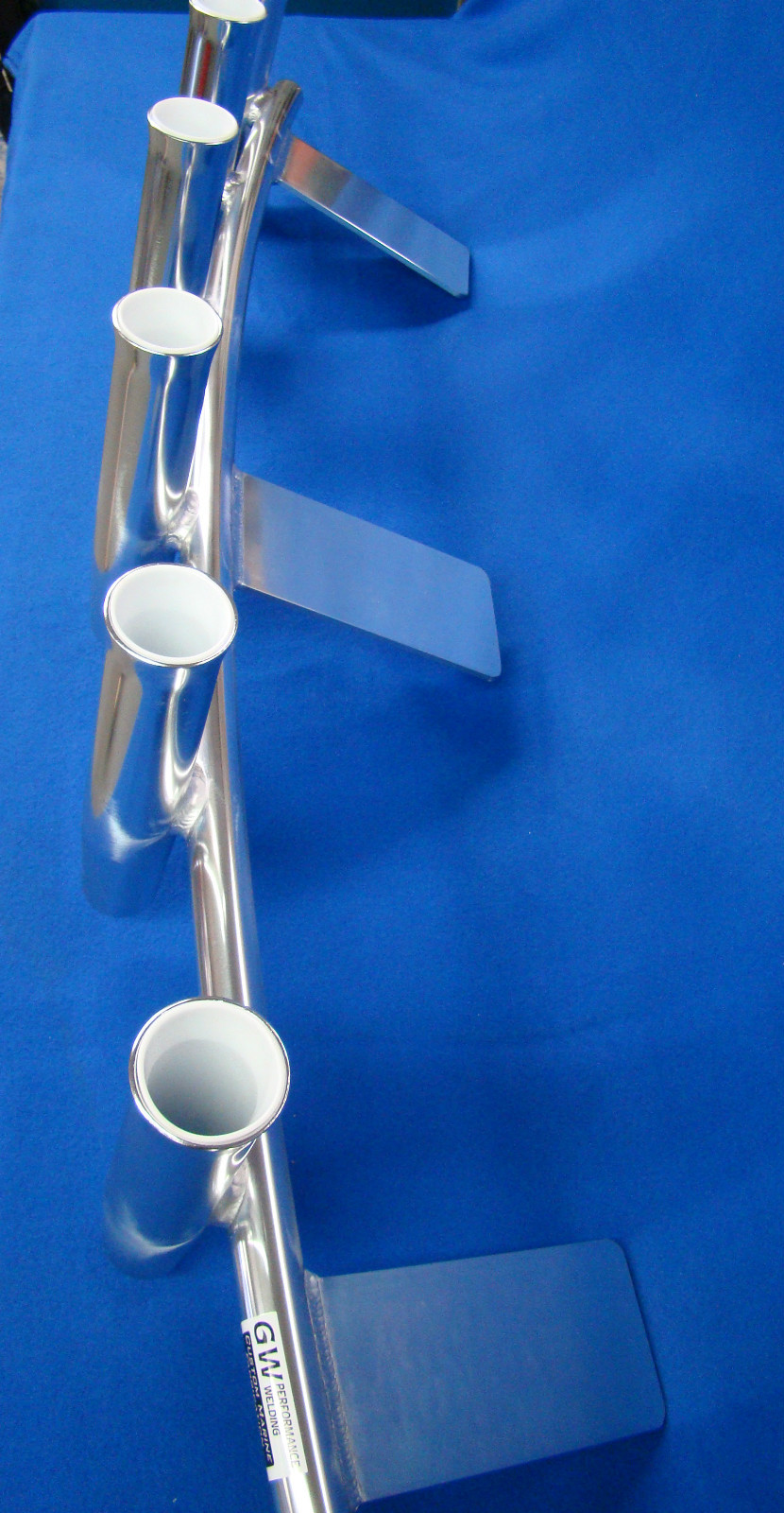

I just bought a 228 G with factory hardtop and it doesn't have a rocket launcher.
Do any of you know who makes the genuine one that GW fit to the Seafarer ? The ones I have seen have 4 rod holders, I would prefer at least 5 . I believe they fix to the hardtop with 3 brackets and e bolts per bracket. Can anyone confirm? Can anyone confirm if they are aluminum ?
As a last resort I'll buy one from GW .
Thanks in advance.

These are all the close pics I have of my 228 factory hardtop mounted launcher. Hope you can see what you need. First pic shows the mounting tabs. WMW Marine was the manufacturer of my top. Reach out to them, they show a 5 place holder as well as the 4 on the website.

Thanks very much for taking the time to put up the photos , are they alloy aluminum or S/Steel?

Thanks for the advice, I will contact WMW . These on E-bay mount with flat tabs on the top .

you have to know your roof angle. If the one in the ebay link was mounted on a perfectly horizontal top, the rods would be at 15*, which is what I would want, but any slope on the top just adds to that, and gets in the way of casting.

Yes, they are aluminum.
Those eBay ones look nice and may very well fit, but if you're thinking GW welding stands for Grady-White welding, it's actually the owners name, still might work though.
With your parameters and the AU logistics, I would recommend you stay with WMW which seems to still be Grady-White's preferred vendor for their hardtop and accessories. I'd reach out to them if you're looking for something custom and see what they can do. I'd be more comfortable with the original manufacturer building a add on rod holder than someone else.

I understand the GW is G w Performance Welding LLC, they are in NJ. The problem I have with the WMW they are only 4 rod holders , I would like 6 or at the very minimum 5. GW make a 6 and it is 52" wide with 3 mounting tabs, that should fit , I may have to relocate the spreader lights.
I would be grateful if you could measure your hardtop width at the rear also if you could tell me how much the middle of the hardtop protrudes further to the rear than the sides and how much higher the middle of the hardtop is from the sides, from my research should be about 1.5" on both measurements.

^^^ This is very important. The hard tops definitely have a roll off on the edges and are curved (port to starboard) as well. You want to make sure the top guns have the same curve. I'd get some prices and then bang them against WMW. The one thing with the latter is you know they will fit. The one downside, is the height is fixed. Depending on your height, reaching them (especially the center) can be tough for some folks. If you do something custom, you can drop the height a bit if needed.

Maybe ask WMW if they would do something custom for you - extend the holder and add 2 more tulips? Outside of the curve and bracket angle, you want to make sure that the tube that holds them together is positioned properly for your hardtop. I think the best options are: Factory or go to a local shop and have them measure to your boat. Buying something stock off the net and hoping it fits probably isn't the best idea.
In addition with regard to an "off the shelf" rocket launcher you should pay attention to the depth of the mounting brackets. On my boat the mounting bolts/washers came very close to the hardtop support crossbeam.
