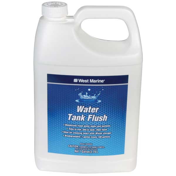

I'm thinking the bleach advice and I'm intrigued by the West Marine Water Tank Flush Cleaner that Ponquogue mentioned.
