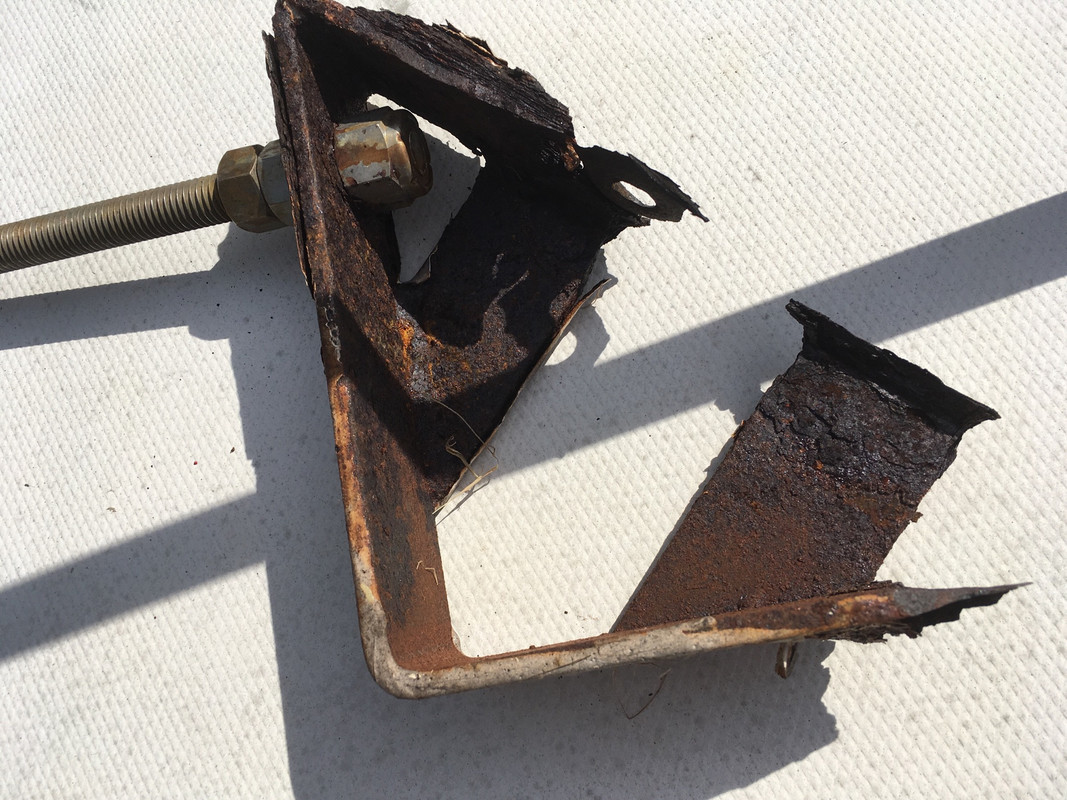

I have this exact problem! it's rusted out and I need replace it, as it's not structurally sound or safe anymore for the D-ring towing loop OR the cleat uptop. Where did you find the parts? Grady was no help...

got it out today.... hacksaw to the threaded rod. this must be a recall! (34 hrs later ) if it's happened to others. Now to order new parts and try to fit it back up as original... or I'll just say screw it ... and fasten a piece of coosa under the cleat, and bolt it back down. I don't trailer sinai don't need the bow ring for towing (stays in the water). Also, I sealed the bow ring from the outside, so it doesn't get worse....

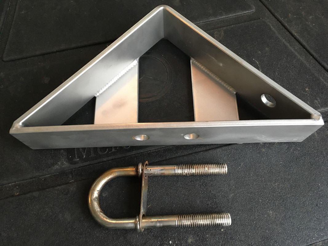

I just replaced mine in my 1988 24 offshore also. Had a weld shop fabricate it out of stainless steel. Cost me 200 bucks and will last forever.

Yup, you can definitely just use the bow eye (trailering eye) for lifting. That's essentially what is being done by using the cleat on the topdeck. Attaching a lifting strap directly to the bow eye is even stronger, though, as the straps are pulling against the bow keel. As an extra safety margin, do as suggested above and add a backer on the inside of the bow keel.
For cleating the boat while in the water, though, it might be a good idea to glass a piece of 3/4" marine ply to the underside of the deck - I don't recall how thick the deck is, off hand.
This was the original in my Offshore (absolutely ridiculous to use regular steel!):
This is the new one that I had made locally out of SS:

I do not. But there's probaly zero chance they are the "same" bracket. It's not an off the shelf piece. Mock it up with some cardboard pieces or strips of luan. It won't be too hard to do.
