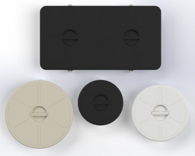

Another weakness of the 330 are those 6" inspection ports in the rear splash well. You have Five of them there. The gaskets get crushed and dirty and they all leak eventually. If the 6" lid pops out (as with someone posting above) - you're really screwed!! Best thing you can do is to remove your five 6" pop out plates and toss them in the garbage. Forget the 100# mono idea. You're far better off replacing them with the screw in kind with the mounting rings sealed with 3M 4200 or equivalent (not silicone). They leak hardly at all and they will not pop out.

Glacierbaze I removed the pop out splash well hatches some years ago and replaced then with 10 inch Armstrong hatch covers (deck plates)They can not removed without loosening them manually. Also allows better access to the bilge area. Check them out.
