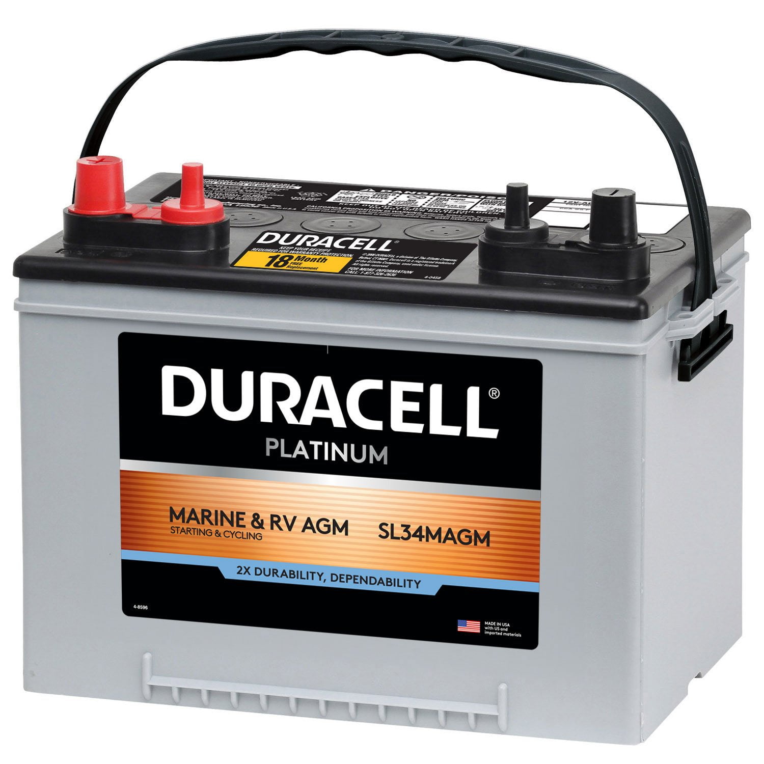

I am right in the middle of a complete redo of my 96 Islander, it had a single 300 hp and I upped it to twin 175s, So I needed to up the battery power, after checking out a variety of options I decided I wanted AGM batteries, of course they are the most expensive, I was already shoveling cash at this , so I figured what the hay, I did manage to save some, quite a lot, by buying at a local O’Reillys auto parts 3 Marine/ RV group 34 AGM ‘s for $519
at most any other it would be $900- $1200
Granted they may not last 10 years , but 3-5 years is fine with me
