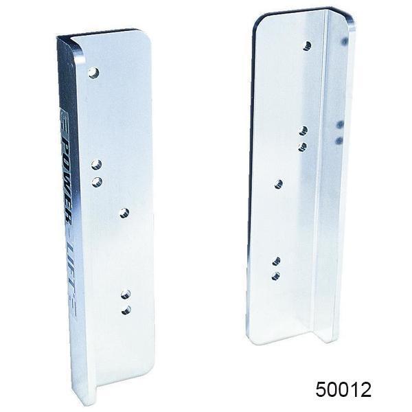

Chuck, those pieces are for extending a pre-existing jack plate. Like if you are going from a prop to a jet outboard.
When you shop, remember to check the weight and hp limits of each unit. Not all manual jack plates will hold a 250 hp motor.
Interesting since I used on my 87 offshore with bracket to use a 30” shaft zero additional setback and I called the company and they said I was good to go. I have no issues and you can modify it to get the height you need.
You can use it on any transom to raise the engine. But it is a fixed extension, not an adjustable jack plate that the OP is asking about.
