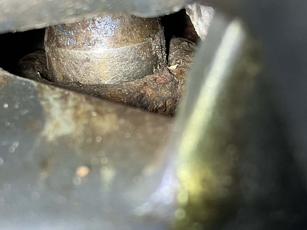

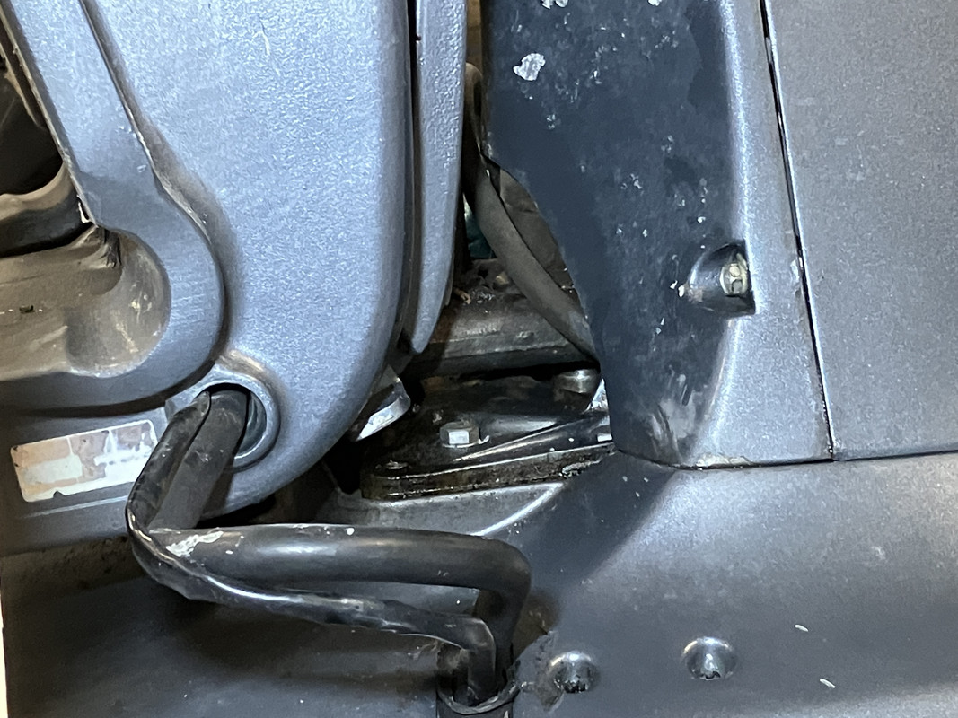

Here we go! The only bolts that are in are (4) of the main ones - and they are only halfway in.

Dennis,
if there is a small gap, you may have luck using a bunch of wooden wedges. Whack them in a crisscross pattern and see if you make any progress. I would not hit the drive wheel or crank.
7,228
1,354
Dennis,
Yup - I have few small small wedges in the front and back. They're not in very far as this point - the front gap is maybe 1/4" or 3/8" while the back gap is about half that.
