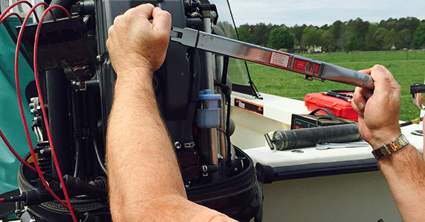

You’re getting good feedback. Engine and lack of general maintenance is a red flag at that sticker price.
here’s a helpful article on engine compression (ideally each within 10psi of each other):
