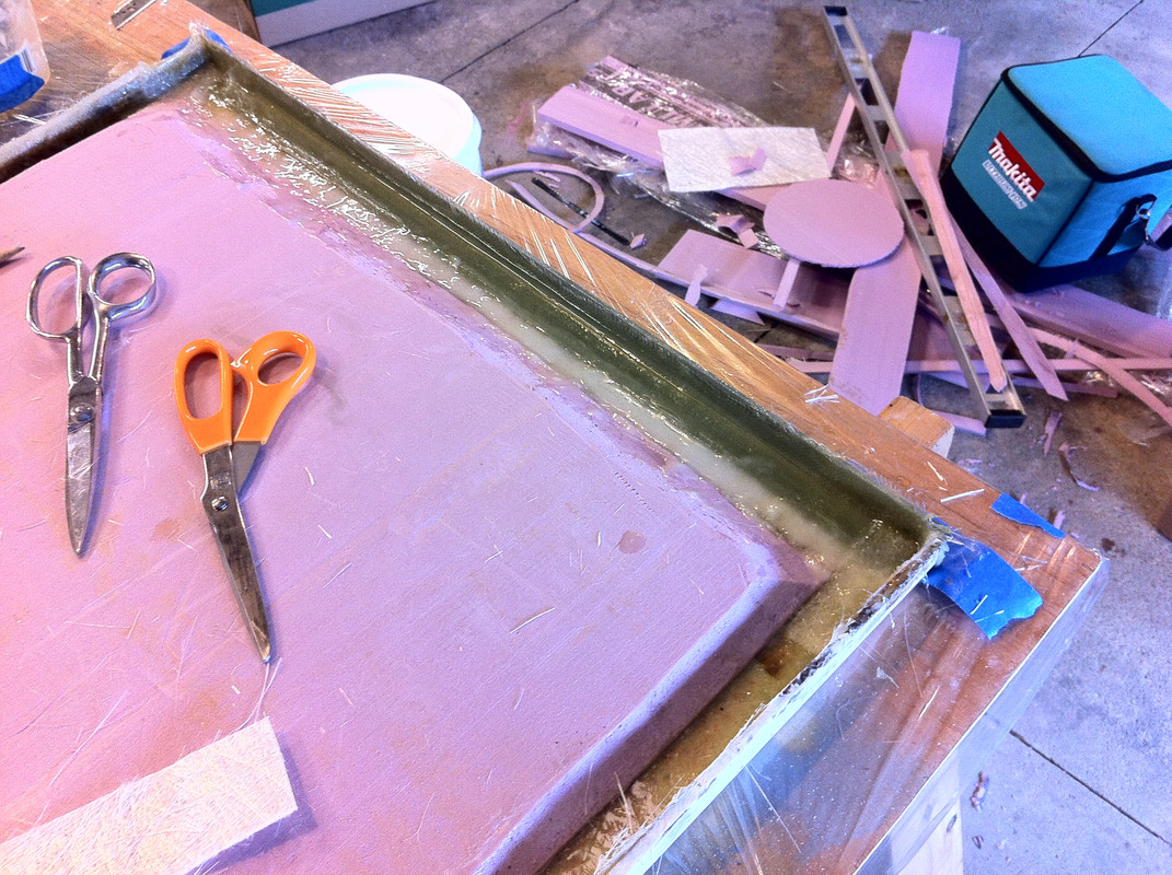

a lot of real boats have hatches that don't screw down. they have drain channels formed in the deck that go to scuppers overboard. The core of the hatch is nowhere near the edge.
The pink foam works (with epoxy NOT polyester)as long as the bond is good. So does end grain balsa and vinyl honeycomb.
Having a strong core is a backup for bond failure.

I hear 'ya. I posted my experience for information/reference/ and the "hmmmm" factor. I'm in no way "recommending" using foamboard to anyone else - I relaize it's not the norm. But it is quite interesting how well it's working. As I eluded to - on this hatch, I could rebuild it in just a couple hours so I wasn't worried about the time factor. But again - that's just me! :)
