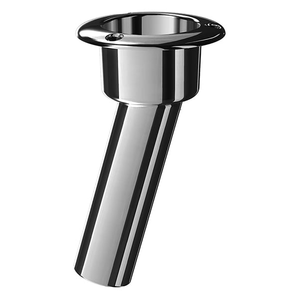

There are several manufacturers....
I think he is not looking to replace the cup holder but rather find a rod holder that would fit into a cup holder. I would think that a cup holder is much more shallow than a rod holder so I am not sure how an adapter might work.
You could of course get rod holders with the appropriately sized mounting that would attach to the forward supports of the hard top. Leave the cup holders for the beers.

amf - I have been thinking of these myself, have you tried them? just curious if they can put up with heavy trolling rods etc. Thanks
9,526
1,420
Interesting product. It doesn't bolt to the gunnel though, it it held by a big nut on the underside. That implies that you need access to the underside of the gunnel and in the case of the original question, requires removal of the old cup holder and I have concerns that the hole size might be different and/or the original bolt holes may not be covered by the flange of the new cup/rod holder.
You also need a special tool to install it but you can borrow that from the company

That rod/beer holder looks cool. Anybody know if it fits the standard size Grady cup holder?
4,503
1,610
I replaced the plastic cupholders in the tailgate with SS rodholder/cupholders...cheap ones from eBay. They fit the hole perfectly. They work good as a rodholder but a can does rattle around little.
In the pic it is at the edge of the tailgate. Also, in the gunnel there is a Gemlux heavy duty swivel rodholder with the big nut on the bottom and no screws in the flange. That is a solid rodholder for sure. You do need access to get that nut on. I did not need the special wrench because the gunnel is wide open.
With any rodholder or cupholder you need to consider if it needs to have a drain out to the deck. You don't want them draining to voids.
