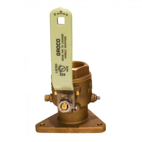

Most of the old ones have a small drain plug, which can be replaced with a grease zerk. Some of the newer ones(Groco) have a drain and a zerk. Grease them in the open position, or the grease goes into the center of the ball valve, instead of against the side.

After freeing it up (PB Blaster, silicone spray, etc - and/or adding the zerk), be sure to exercise the seacock once a month to keep it in good shape. Use to some leverage to get it to start moving - some handles have a square that a socket wrench can be inserted - you can also slip a pipe over the handle for extra leverage. A little bit back and forth, back and forth should do it.
