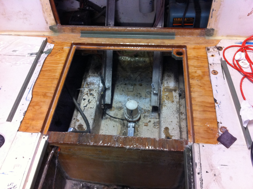

Anything is possible! You'd have to create a gutter system. This is partway through my build (gutted it) of the entire cockpit floor. And this section used to be entirely open as the boat was originally a sterndrive. However, this shows a basic idea of how you can build a gutter. I had to completely fabricate a new hatch, but the underside stuff is basically the same. I used fiberglass L-channel around the inside perimeter to make the gutter, then plumbed the drain into the port side cockpit scupper drain hose. The L-channel is a little short (can only be so high because of the lid) so it doesn't catch all the water - but it does a decent job.
