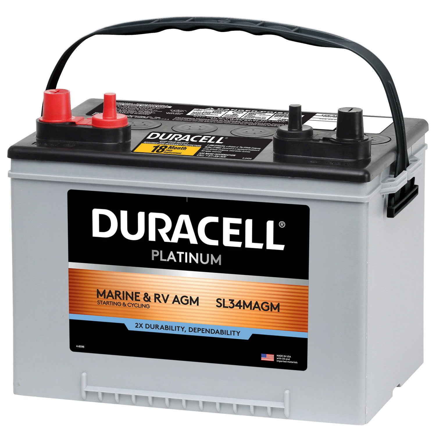

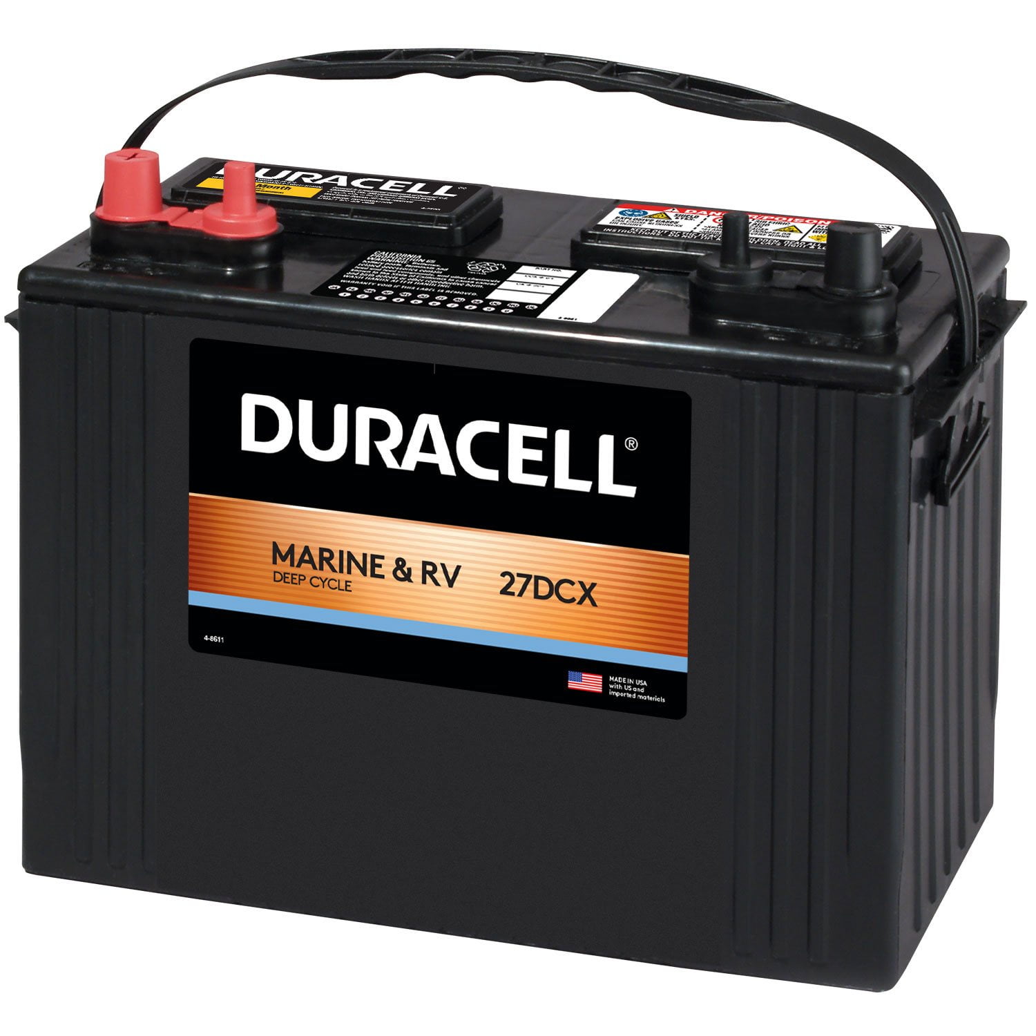

There's no question that AGM's are superior to regular LA in terms of vibration resistance, being better at supplying consistent voltage and longevity. That's well documented and proven. Those are facts. As we talked about a couple times, though, whether that's worth it to an end user when comparing prices - that is completely opinion-based. And probably largely based on someone's experience with regular LA and how they use their boat.
I will add... some engines REQUIRE AGM's for the reasons said above. These engines need clean. consistent power - otherwise their various computers may do funny things. This is also fact - certain Mercruiser sterndrives and many of their larger OB's require this. I can personally vouch for this as being true - not just from what Merc states but from seeing problems when regular LA are used. I can't speak for other brands as I don't have the in-depth experience with them.
