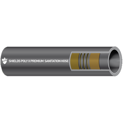

Great to find this info! Had some trouble flushing the head today on my 2005 282 Sailfish and discovered a similar leak reported by @wahoo33417. All this info gives me a great start. Thanks!It's prob the same as my 2002 282. I replaced the line from the toilet to the 1.5" loop this offseason. The access is via a removable panel on the stbd side of the mid-berth. Piece of cake to get to, the hose requires a little wrestling and a heat gun helped me gain a little extra pliability in the removal and re-install. This was on a frigid day in early March. These systems require regular maintenance and inspection just like any other on the boat, if not, you'll inevitably have an issue. New joker valve, make sure the vent is clear, inspect the hoses, and so forth. My line was in tough shape so that's why i replaced that one, I'll probably do the others this upcoming offseason. Those black hoses tend to dry rot and crack, only a matter of time till they leak, and if they do you would see what your seeing. Either that or you have a loose connection or a compromised duck bill, these are simple systems. You can get a new duck bill at West Marine, pretty cheap, or clean yours if it looks ok. The holding tank is behind the aft panel in the mid-berth. If your under the hood anyway you should pull off the vent line, which is accessed via the same stbd panel AND the aft panel. I had a clog in each end, and in that L shaped fitting that goes into the tank from vent line. Mud wasps love to make nests at the far end where it exits the hull.
