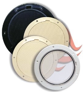

If you have an 8 inch plate and it is a snap in style as opposed to a screw in type, here is the Bekson part
That said, I think you have a 6 inch plate. Measure the opening size ( with the plate removed), not the o-ring size

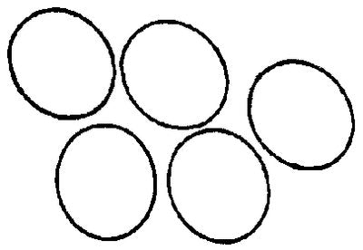

If you have 6 inch plates, here is a set of rings
I have a 2003 Grady Marlin 300. These are the pop in plates, not screw type. The diameter of the opening is about 7 1/8 to accommodate the plate. It is original Grady equipment.
I am still not sure what ones you have. Here are the specs fo the 6 adn 8 inch options
6" Pry-out Deck Plate - Standard Trim Ring Replacement Gasket = D6P-G
Outside Diameter: 8 1/8" (15.6 cm) Inside Diameter: 6 3/16" (15.5 cm) Hole Cut: 6 1/2" (16.5 cm)
Thin Rim with or without screw holes may be available in some color / material combinations. Thin rim OD is 7.50"
8" Pry-out Deck Plate - Standard Trim Ring Replacement Gasket = D8P-G
Outside Diameter: 10" Inside Diameter: 8" Hole Cut: 8 1/2"
No thin rim available.

Beckson made the original ones for my GW. They will sell direct. They made them in different colors. Today you are probably dealing with "Faded Grady" - almost white with a slight hint of brown. Get your o-rings from them or if you are willing to experiment McMaster Carr has lots of o-rings. You need to measure carefully.

I replaced my o rings from home depot, took the plate in and found a match to fit. I also remove my plates to dry (stern and mid deck) out the fuel tank areas . It helps with venting the fuel fumes that seem to somehow escape a little with the plastic tanks while resting comfortably in her heated home........Yes my 208 is rather spoiled, but she is (12 years) use to it now so any changes could result in her possibly misbehaving on a good fishing day....just won't take that chance!

I saw someone post an EBay link for Cat O rings that fit the 6" pry out. I can't find the link now. It was for 3 O rings at a very good price, with a robust o ring that works well.
I'll look for the link.
Looks like the price went up. Here is the model number in a photo.Screenshot_20221228_191037_eBay.jpg
